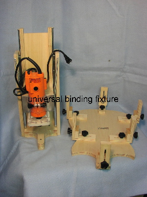

Any good binding system uses the sides to square to and the top or back contact is nothing but a height plane that the base rides on. you can get Teflon donuts at Wally World that are use in nitting and glue one on the base. they are about 1-1/2" od x 1" id these work well for the ledge on the router base. Small enough not to be an issue with the dome slope. Trying to use this hand held is near impossible as the surface area of the base is now so small that it is hard to keep level, but on a floating base with a pilot guide indexing to the side in workse well. I use Johns Halls binding fixture
I addapted mine for a PC 7310 and added an adjustable pilot guide for setting the cut depth.MichaelP38733.5093634259

Ken that is a simple way to approch a base for hand held routing binding channels. My only concern wold be as you turn the apex of the upper bouts, due to the small area of the dome there, I would think you would loose the some surface contact on the base there by causing the vertical depth to change fractionaly by tilting slightly right or left, till you complete the tight corner. This may not be a big issue depending on the width of the base, but is the reason I like a free floating vert. fixture with a small base contact point.MichaelP38733.5896759259
